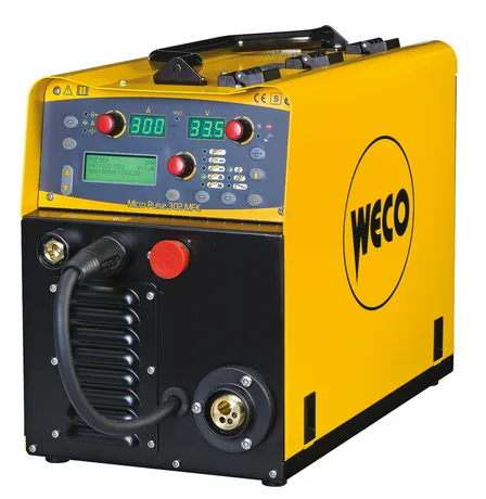

    Micropulse 302MFK:

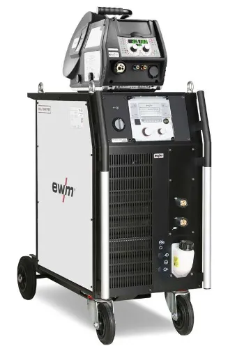

    EWM Alpha Q 351 Expert 2.0 puls:
